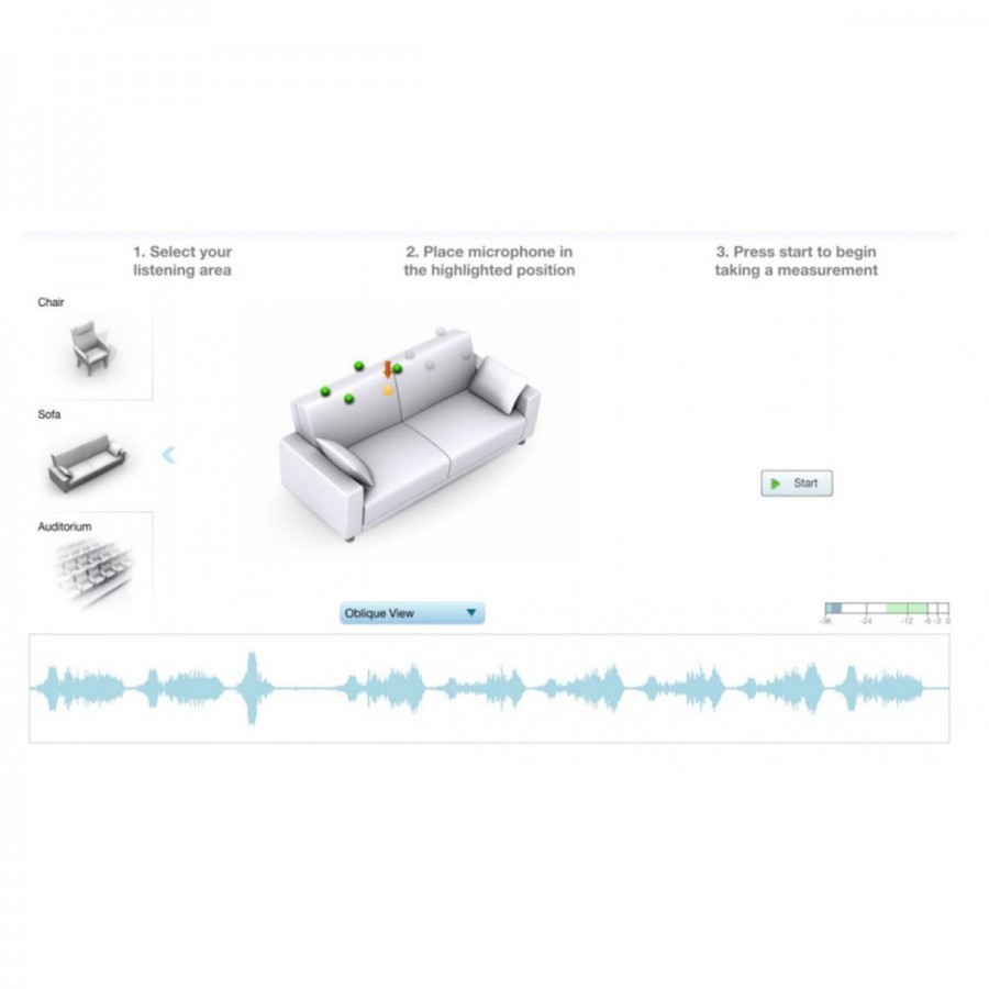

DIRAC is a different software tool for measurement, which is a bit frustrating, but it has worked for me OK.

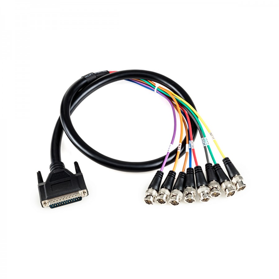

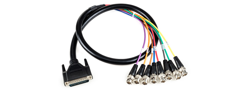

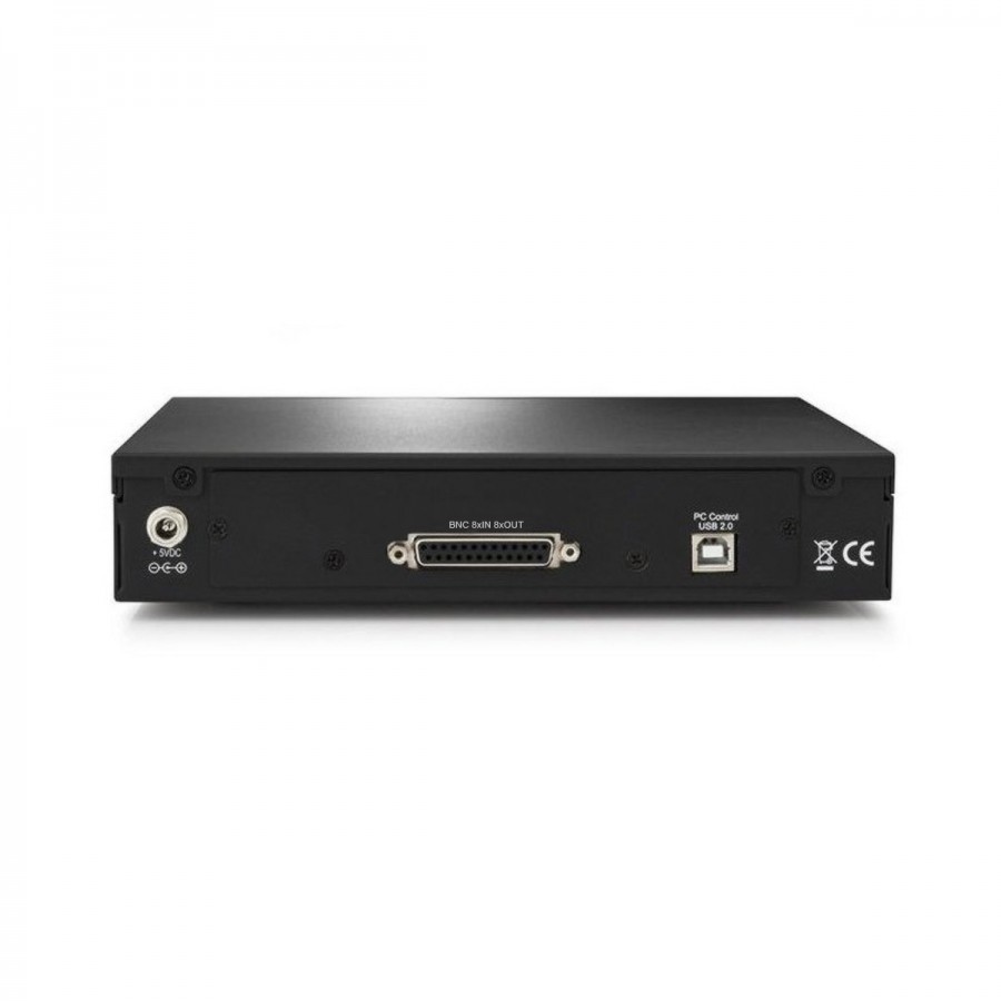

The only pain is that all the SPDIF connections are BNC. I looked at getting a different Tascam style 25 pin connector with RCA plugs, but that wasn't cheap. Some BNC to RCA plugs solved the problem in the end.
If you are going to use this in a home audio scenario, then make sure you get the SPDIF version if you have SPDIF level kit. The AES/EBU version does run at higher signal voltages IIRC.
