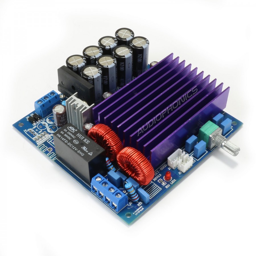

The DIY TDA8950 amplifier module from FX-Audio allows the design of a high-performance amplification system capable of delivering a power of 2x170W at 4 Ohm or 300W in BTL. The card benefits from a compact volume thanks to the latest generation of Philips NXP Class D chip. Equipped with a large heatsink, it can be easily integrated into all quality amplifier projects such as home theater and hifi power amplifiers. It is also ideal for designing multi-amplified active or passive systems. The module offers 2 single-ended inputs.
Surprisingly musical and dynamic, this module is a relevant choice for the enlightened amateur at a controlled cost.
Product typeAmplifier type
Amplication chipTDA8950E
Power2x170W 4 Ohm, 300W BTL
Power supplyAC +/-24V (Min 16V / Max 28V) (transformer sold separately)
Integrated potentiometerVolume control
Dimensions100 x 100mm
Weight200g

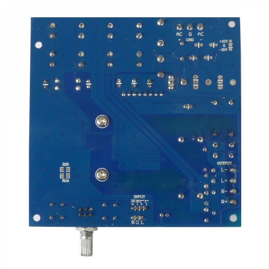

Wiring diagram
FX-Audio M-DIY TDA8950 Schéma de câblage
1AC +/-24V Power Supply Input
2Speakers Output
3Single-Ended Input
4Single-Ended Input
BTL Wiring Diagram
Schéma câblage BTL FX-Audio M-DIY TDA8950
