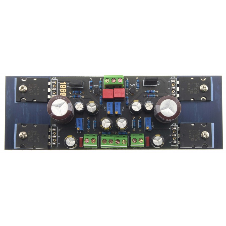

Quiescent current can be adjusted with W202 trims, and output bias with W204 ones.
