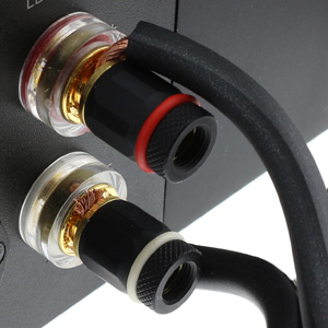

Step 6 : Connect the cables to the amplfier
To connect the cables to the amplifier, run one conductor from one end of the cable through the + (positive) terminal block and the second conductor from the same end through the - (negative) terminal block. Make sure that drivers do not touch each other. Screw the terminals back on by turning them to the right this time.
