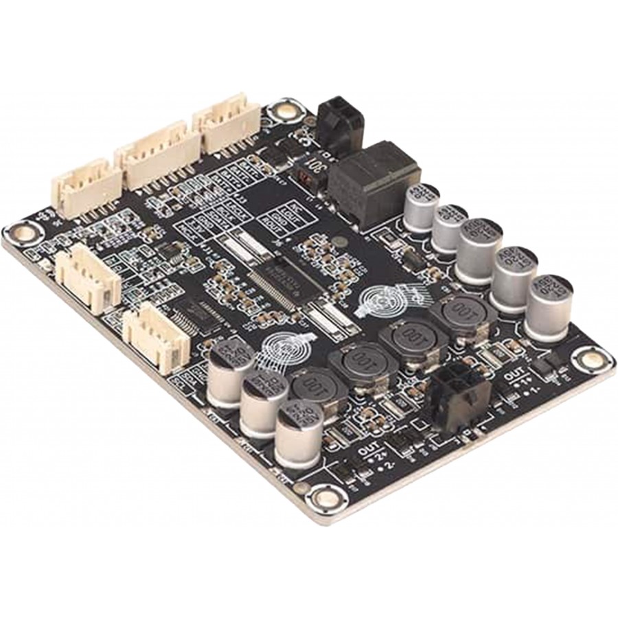

The Wondom AA-AB32257 DIPO2 is a stereo digital amplifier module with I2S interface designed to ensure direct signal conversion and amplification, relying on the TAS5768 circuit to limit intermediate stages and preserve audio stream consistency. It delivers 2x50W into 4 ohms with support for up to 192kHz / 24bits, thereby maintaining source signal resolution while ensuring stable reproduction with a signal-to-noise ratio of 103dB.
Intended for digital audio integrations such as embedded systems, compact configurations or standalone projects, it combines a simplified I2S input without MCLK, a usable analog output for preamplification and direct compatibility with battery power supply, allowing the structuring of a complete audio chain from a single digital source.
Wondom AA-AB32257: I2S digital amplifier and high-resolution audio reproduction
The DIPO2 module relies on a fully digital amplification architecture integrating the Texas Instruments TAS5768 circuit, allowing direct processing of I2S streams to limit intermediate conversions and preserve signal integrity. It supports resolutions up to 192kHz / 24bits, while PCB routing optimization and calibration phases ensure a signal-to-noise ratio of 103dB and THD+N distortion of 0.037% at 1 W into 4 ohms, resulting in stable reproduction faithful to the original content.

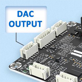

DAC output illustration
Wondom AA-AB32257: 2x50W amplification and integrated preamplified output
Powered at 24 V, the module delivers 50W per channel into 4 ohms, allowing it to drive home or desktop configurations while maintaining usable power headroom. Beyond this function, the presence of a preamplified analog output allows extraction of the signal upstream of the power stage, enabling its use as a digital-to-analog converter and facilitating pairing with external amplifiers.

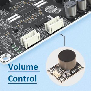

Volume controller
Wondom AA-AB32257: External volume control interface
A dedicated port allows connection of an external rotary potentiometer module AA-AB41152, enabling direct adjustment of the output level without going through a software layer. This approach ensures immediate system response and facilitates the integration of physical front-panel control in various environments.

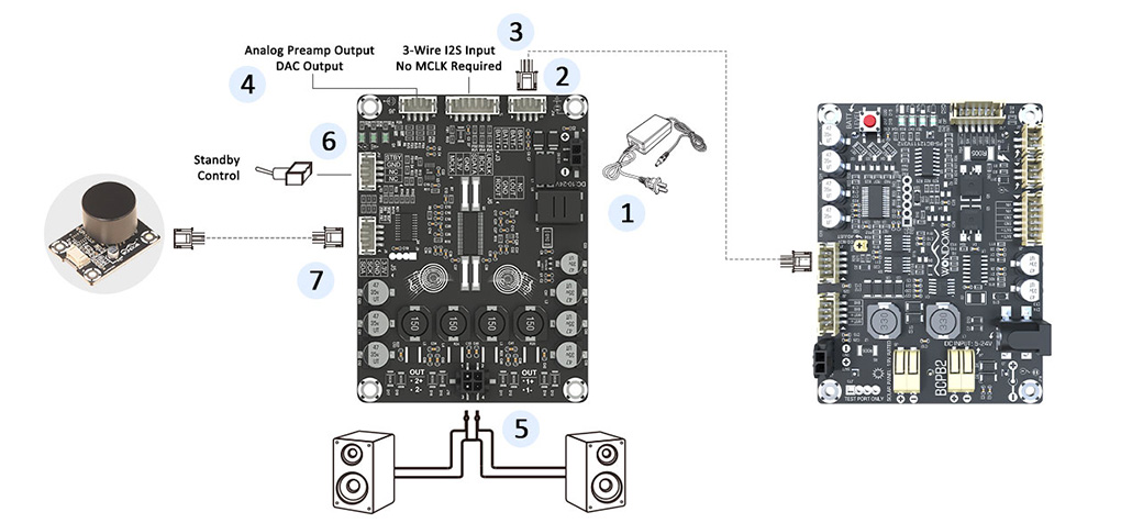

Wondom AA-AB32257 connection overview
1Power supply 10-24VDC
2Battery power supply with BCPB battery board
33-wire I2S input, no MCLK required
4DAC output, analog preamplifier signal
550 W stereo speaker output
6Standby control
7External volume control

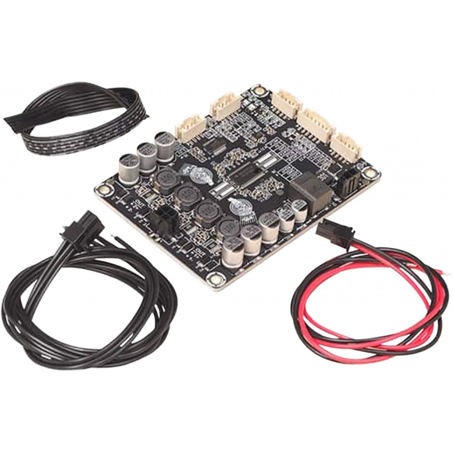

Packaging1xAA-AB32257
1x PH-6Pos ribbon cable for I2S connection 20 cm
1x 2-pin Molex power cable 50 cm
1x 4-pin Molex speaker cable 50 cm
