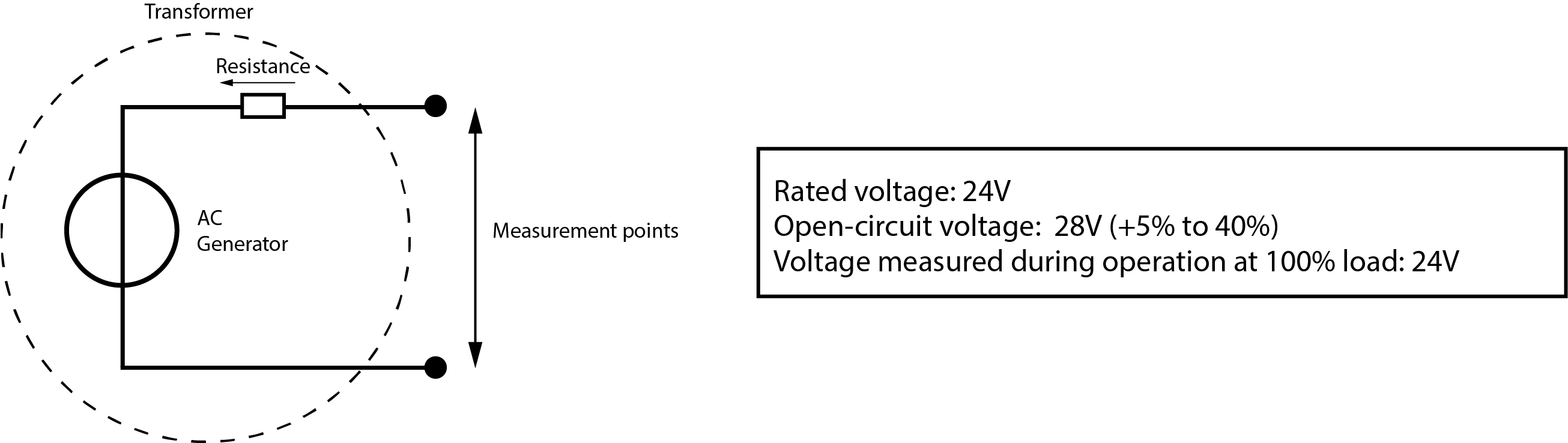

Specified Measurement VS No-Load Measurement
Please take certain parameters into account when selecting a transformer or measuring its secondary voltage. The technical specifications provided by the manufacturer differ from no-load measurements often performed by third parties. Manufacturers specify values under operating conditions and at 100% load, whereas no-load measurements typically show an overvoltage of 5% to 40%. This is simply intended to compensate for the transformer's internal resistance.
Specified Measurement VS No-Load Measurement Diagram
